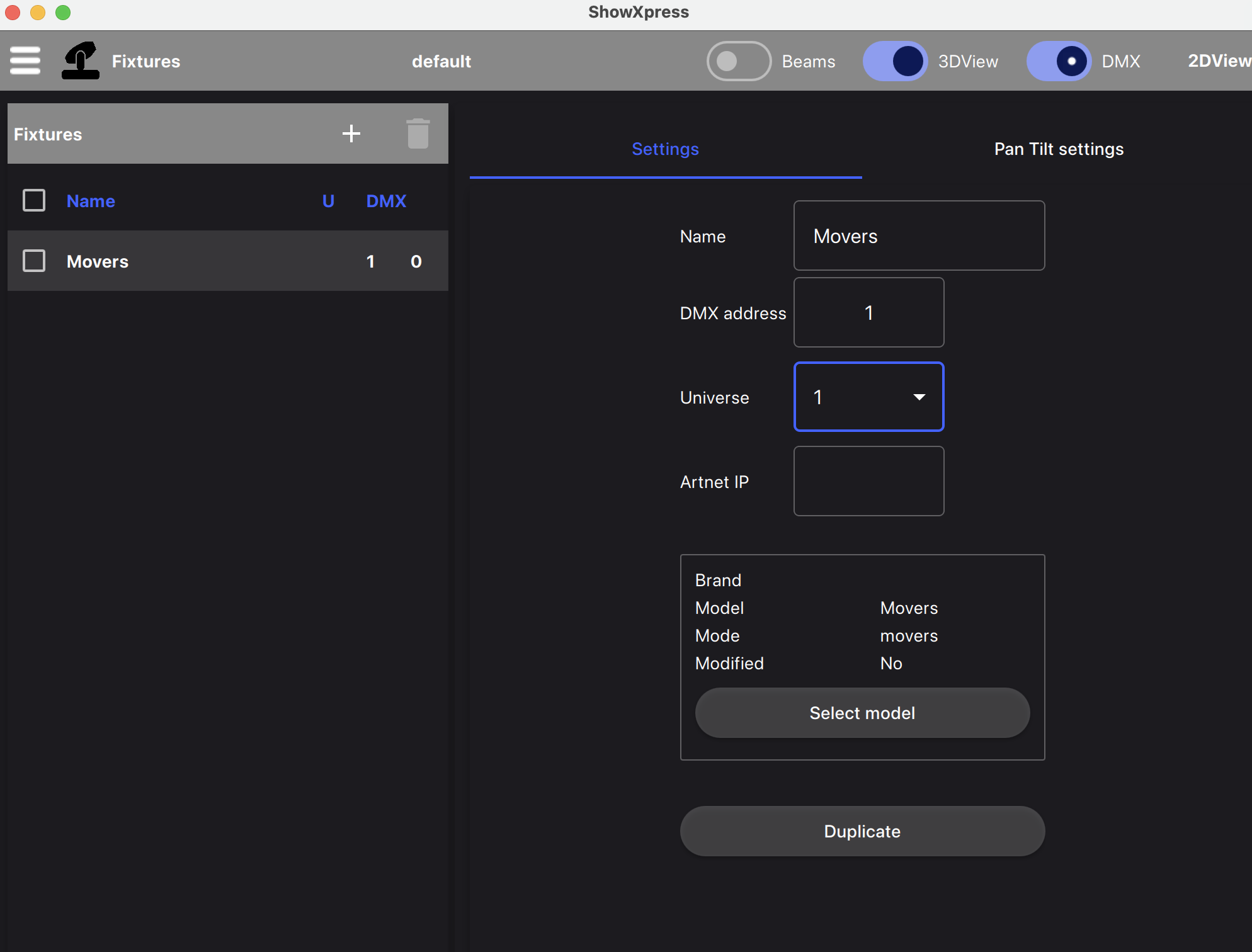

I'm not seeing the Edit Profile button when I add a fixture. Screenshot attached. A friend tried on Windows and had the same issue. I'm using a M1 MacBook Pro / Sonoma 14.2.1. I am following the video. BTW, thank you! I'm really looking forward to this new version
Posts: 672
Re: Making my own fixtures
Oh, we forgot to redo this video. We changed a bit the buttons since we did the video.
To edit now a fixture, you have now to either double click on it, or right click on it to get the popup menu.
Sorry for that ; we have added a note in the video.
