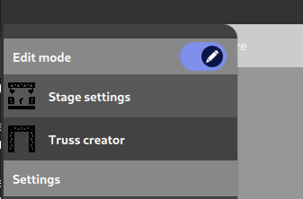

How do I create a stage in 3d View, as is seen in the tutorials on YouTube.
Thanks
Nick
Posts: 701
Re: Creating a stage
There are two importants things to know.
1. use this switch in the drawer menu to enter in the "Edit" mode.
Capture d’écran du 2024-07-14 13-16-02.png (11.29 KiB) Viewed 64355 times
2. in the "Edit" mode, you can add 3D objects with this big blue "+" button (lower bottom screen).
